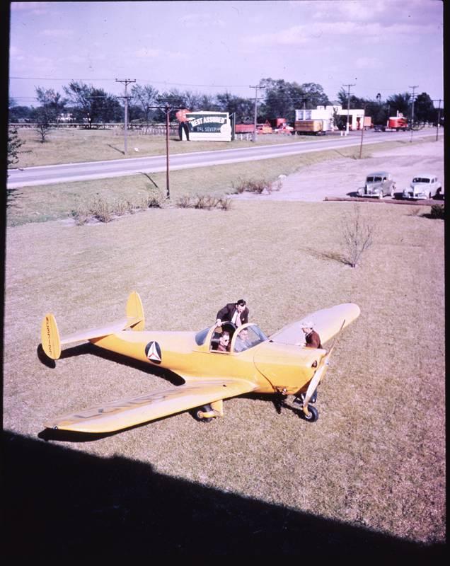

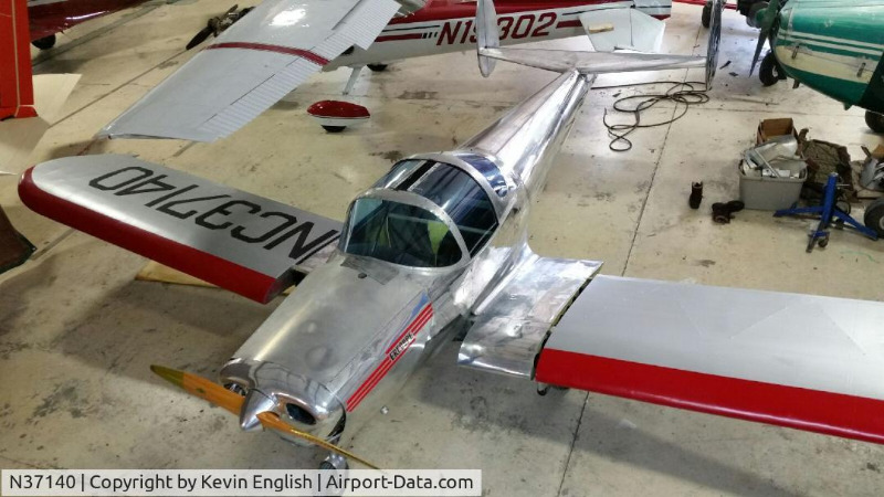

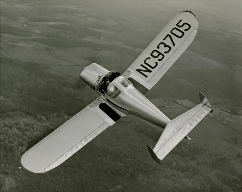

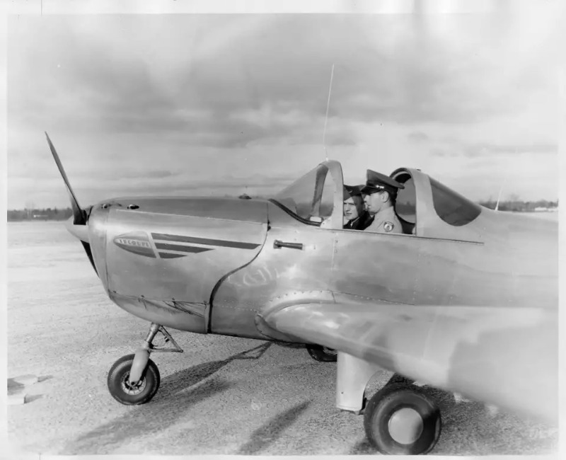

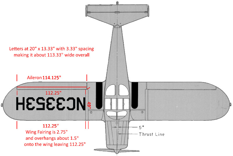

@raymond also understood on the Tail numbers. I did what you you said and took some rough measurements. @arlan understood on the CFR, appreciate the help very much gentlemen. My rough measurements are the last image.

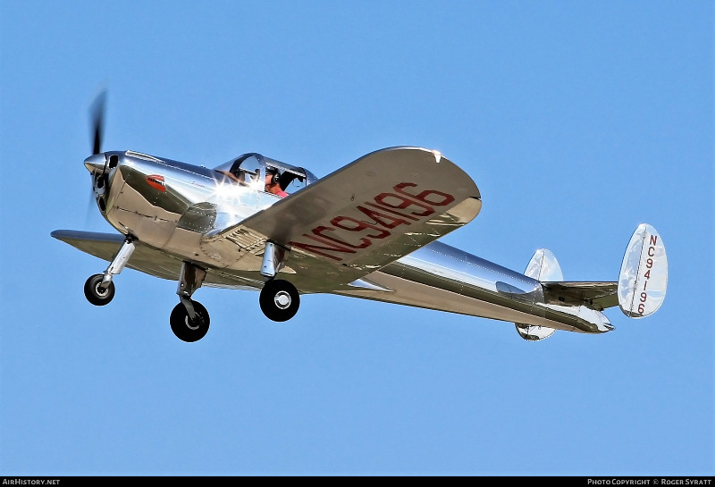

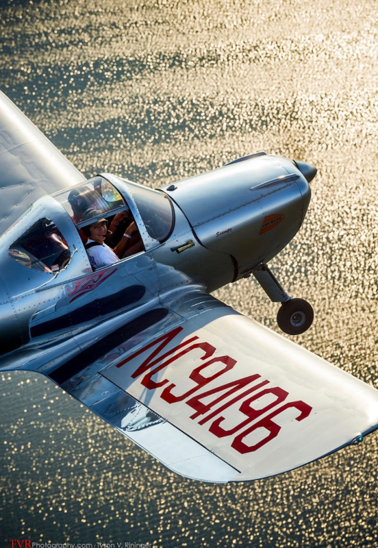

I am considering Scampy's sizing including the tail number size and placement. Here are some WWII and post war C.A.P. Ercoupes for everyone that I managed to scrounge in my travels, including a yellow one!
23 May 2025 13:27 - 27 Sep 2025 09:15 #4
Replied by Mac McCormick on topic NC Tail Number character sizes
EDIT 9/26/25: Changed 20" width to 20" height, I mis-typed the first time.
Making progress and thank you everyone for your help and inputs!
Looks like it all comes down to proportions primarily with a min of 12" tall lettering. Please point me in the right direction if this is off.
So far what I am finding based on your inputs, and like the image you posted, and rereading (and hopefully I am understanding correctly, 14 CFR part 45.29, b., 1., i.), I found photos like the Ercoupe "Scampy" Tail No. N94196 and the Ercoupe "C.A.P". N37140 both show the wing lettering to be as long as the aileron and no longer. The aileron is about 114". Using part 45.29's proportions the height comes out to about 20" height a little over 13" wide with spacing about 3" total length is a little over 113" and fits with the photos and fits with Part 45's "No smaller than 12.". Using 24" height with the FAA proportions, then the lettering goes out almost to the very wingtip and over the wing fairing strip and onto, or right next to, the walkway stripe at about 136" give or take.
