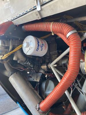

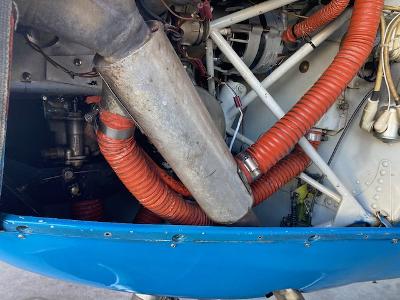

Replied by John Jones on topic Correct duct routing for cabin head in M10
25 Oct 2022 15:22 #2
The cabin heat inlet is off the back of the baffle array, not quite visible in my pic. My baffle actually has two outlets on the left side, one 2" for the cabin heat and a 1" that has airflow directed at the alternator. I'm thinking about partially closing off the cabin heat since #2 cylinder tends to run warmer that the other three so might benefit from a little extra air.

25 Oct 2022 12:48 #3
by Scott Engelhart
Replied by Scott Engelhart on topic Correct duct routing for cabin head in M10
John, Thank you for your response and picture. What I still need to know is where does the tubing that connects TO the heat muff come from. Is it from the LH engine baffle (can't see in your pic) OR the inlet on the nose bowl which is where I have it during summer.
