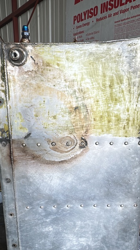

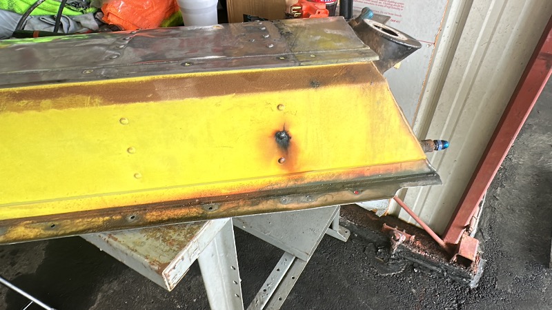

- Keith Whitcomb
04 Jun 2025 22:59 #3
by Keith Whitcomb
Replied by Keith Whitcomb on topic Fuel leak
I pulled the left hand wing tank off my Alon for a couple of reasons. I found evidence of leakage at a rivet on the back of the tank. You would NEVER see that unless you entirely removed the tank.
Drill the leaking rivet through with a #40 drill bit. Drill the rivet head off with a 5/32 bit and punch the tail into the tank. If you have the tank off you can shake the tail out. A CR3213-5-2 cherry max rivet coated with some fuel sealant and you’re down to reinstalling the tank.
I also found leakage around the fuel gauge glass. Vernon Gregory @skyport had the gaskets in stock.
