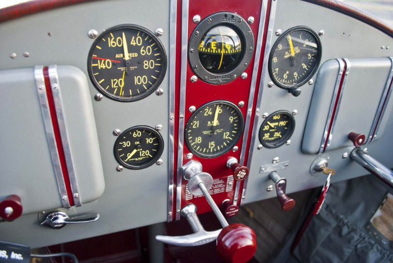

Back to instruments, Vern sold me a good used Turn & Slip and a Venturi to go with it, that is painted light blue enamel. I am assuming I can strip the venturi (very carefully with non-toxic stripper) before installing? Does anyone have the venturi like the one on Scampy? (N94196), owned by Syd Cohen? Are there instructions for mounting that type venturi and/or photos?

I did get a WWII era Bendix B-16 compass (Re-lumed and non-radioactive!) from AirCorps Depot (www.aircorpsdepot.com/). I did find an old Turn & Bank (refurbed non-radium also) and a venturi to go with it. That will be installed on the next Annual this January if all goes well. The search continues. I only need now is to find an older vintage Altimeter next.

Original engine instruments were automotive. There are a number of suppliers of automotive instruments made in vintage styles. Flight instrument styles haven't changed much and you can still buy them, although the cheap ones are made in China and are of low quality. Probably better to rebuild an original if you have it. All the original instruments had radium dials so the numbers glowed in the dark. They stopped making those when the workers started developing cancer, so that is a feature you won't often see in restorations.

Hope everyone is doing well. Time to ramp up and start restoring in earnest. Where/how can I purchase the original instruments used back in '46? Goal is to return the panel to as original as possible.
