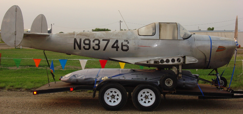

I think you will have a hard time finding a car trailer wide enough. I hauled mine 1000 miles on a car trailer (photo attached) without incident. But I had to clamp a steel channel (the pull-out loading ramp from the back of the trailer) across the bed so the mains had something to sit on. Otherwise, they straddle the bed. The nose gear barely fit on the bed, but it could have been tied to the tow bar, also. The plane had to be loaded from the front of the trailer because of the fenders. I built ramps with concrete blocks and a couple of wood 2x8's then used a come-along to pull the plan up the ramp onto the channel.
