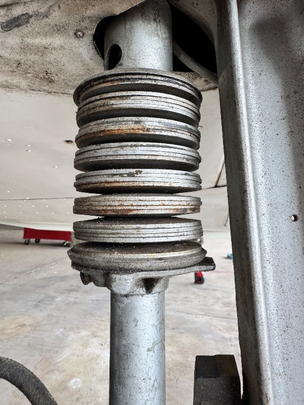

Replied by Brooks McNew on topic Belleville Springs & Tail Height
I used the Alpha Aviation spacers with my Bellville-Spring MLG and they worked perfectly.

Replied by Super User on topic Belleville Springs & Tail Height
That certainly would work. I would reach out to Vernon Gregory (he has ads in every Coupe Capers) or try him via email at: vgregoryg (at) aol (dot) com

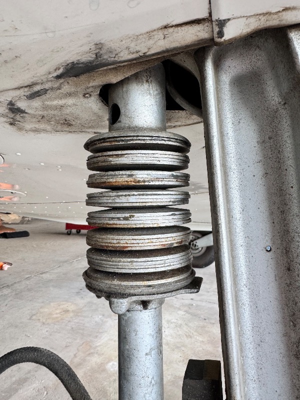

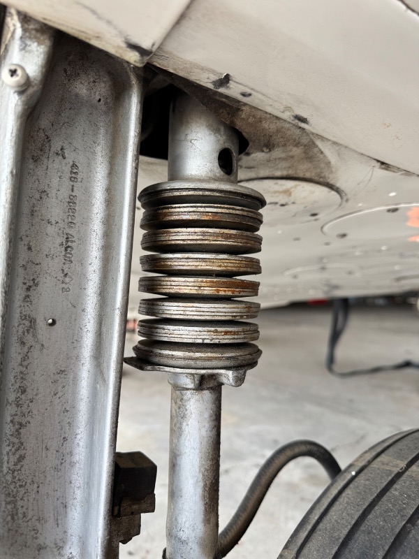

Belleville Springs & Tail Height was created by Norrie Gregoire
Just took ownership of Alon A2 N6566Q and have lots of questions. Looks to have Belleville springs rather than donuts. Tail height is at 67.5”. I have 5” nose wheel tire. Canopy sill is not level. Do I add spacers to increase tail height?
