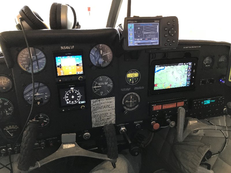

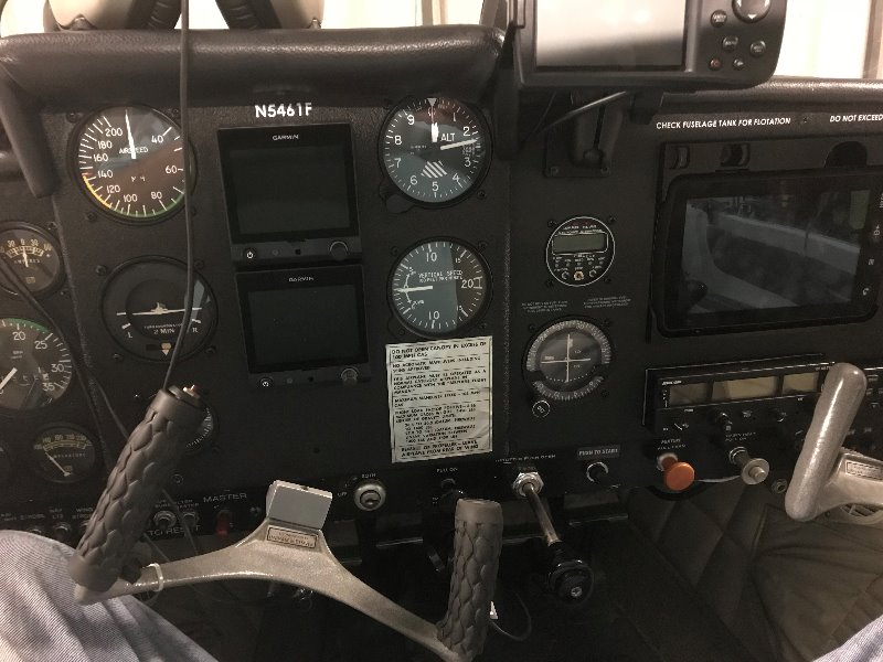

The Alons and Mooney's have a different panel arrangement, a three piece panel with the "six pack" section floating on lord mount vibration isolators. I have re-done my panel after removing the vacuum pump. I am using two Garmin G5s which are certified and do not require a vacuum source. I also have a panel dock for my Garmin 796. When I installed ADS-B I also had an LOC/GS indicator installed on my King KX125. In theory, my M-10 could be instrument certified although I would never intentionally fly into instrument weather. My thought was, I'd rather have the instrument stuff and never need it than need it and not have it. I added a USB port to keep my iPad and iPhone charged in flight. Also installed a fuel flow meter since the M-10 has no usable fuel gauge except the wire on the nose tank.
I have flown it quite a bit now in this configuration and am quite comfortable with it.
I did have one issue. I wanted the radio and transponder mounted in a vertical stack so I could add a second nav/com and an audio panel but, as someone noted, the fuel tank gets in the way. I attached a photo of the panel as it currently is.
