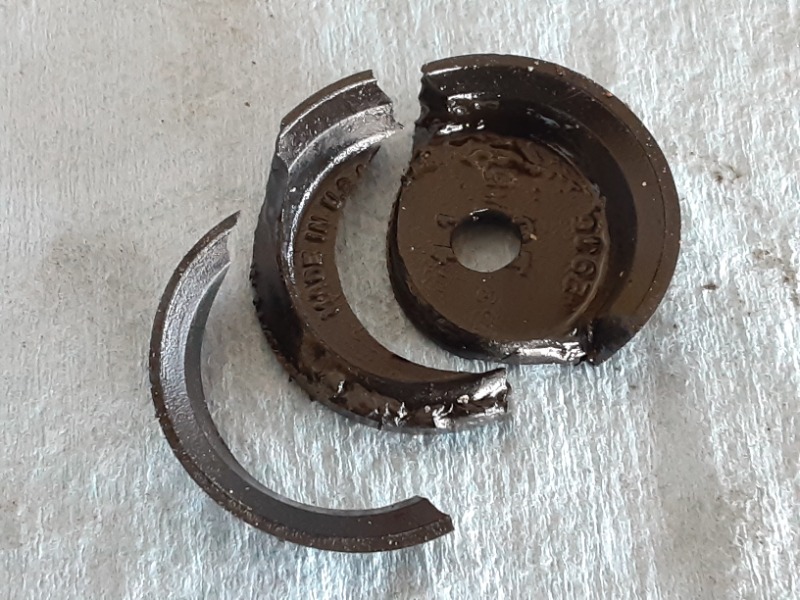

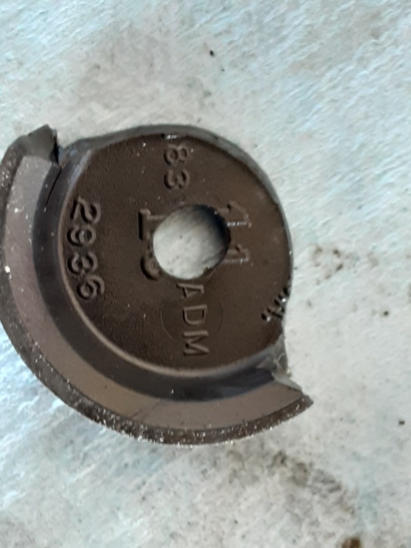

Replied by Matt Gunsch on topic What Oil is used in Alon A2 Nose wheel and Main Gear Oleo’s?
My coupe has the cup seals, not sure what the refurbish kit is. Something to check during your annual is to jack the main gear and lift the trailing arm, if you can lift it with little to no resistance, then the strut probably needs fluid, if you have to add fluid, go ahead and pull the lower part of the cylinder and inspect the O-ring or seal cup. First annual I did on mine I found the cups in pieces.
