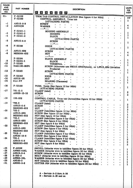

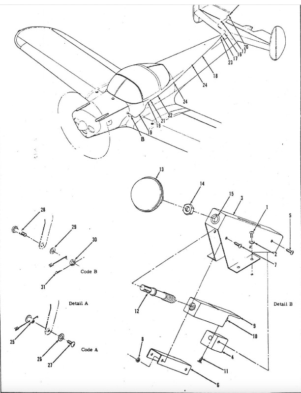

06 Jul 2024 17:49 - 06 Jul 2024 17:53 #3
Replied by John Jones on topic Trim System for Alon A2A
The Alon parts manual lists the cable as: "130-032 CONTROL CABLE Trim tab (Arens)" I suspect the A2A would use the same part. Good luck. John
Last edit: 06 Jul 2024 17:53 by John Jones. Reason: added files
