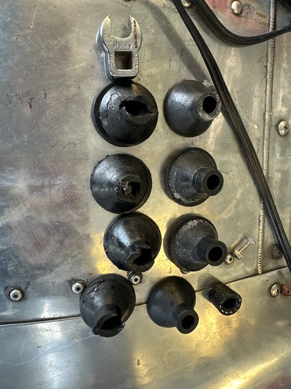

- Broken exhaust caused by worn lower engine mounts

Replied by Randy Phillips on topic Broken exhaust caused by worn lower engine mounts
That's exactly what mine looked like as well. Bottom ones had worn almost all the way through.

- Keith Whitcomb
06 Mar 2025 23:25 #11
by Keith Whitcomb
Replied by Keith Whitcomb on topic Broken exhaust caused by worn lower engine mounts
I spent the day replacing the rubber motor mounts today. Oh what fun! (Not!)
Vernon Gregory @ skyport sent replacement parts. Nobody mentioned that the top and bottom bolts have different lengths.
By pure luck, I got one side right.
I get to redo the other side tomorrow.
