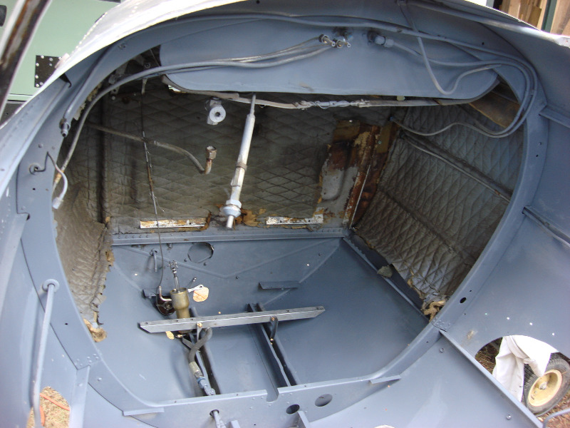

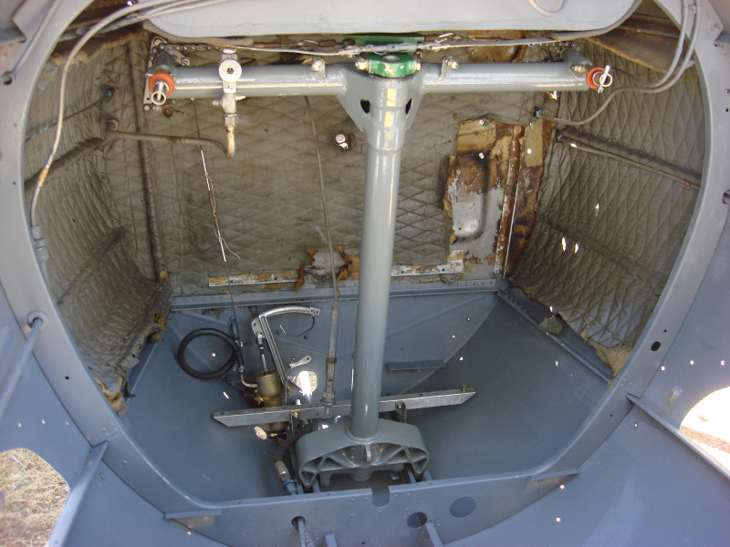

Thanks Warren. I am trying to see how to mount the yoke mast to the fuselage. I see the bottom has two holes for bolting on to the bottom of the fuselage, I see the elevator rod, but that's as far as I can figure. I can see why the pushrod needs to go on first.
Then there's some rigging to do. I will need to figure that out.
I just need some visuals to jumpstart the process.
Thank you

Shawn go to craigslist for Reno Nv there is an ad for a Coupe Over priced but there is a picture of a green mast. But I am confused is it a mast or control Column you are talking about. I have taken pics of the mast in my 415

One of the hardest things to do on and of the Coupe family is to get to the mast Four 1/4- 28 bolts hole it to the airframe but the cotter pins are a bitch to get to. Then the control rods need to be done first. The Coupe needed a removeable bottom like Mooney M20 have. Maybe you could do a 337 to make an Insp cover to work under the mast ( ? ) that been done under the control column. Ps see my views on the suggestion column... And then comment.
