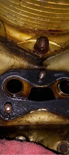

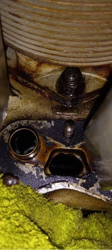

Well, I decided to try and get rid of the annoying oil leaks. We went with the low hanging fruit first...the push rod tube covers. Got a kit from Real Gaskets Tennessee. Upon removing intake valve covers, gaskets shot and nut rusted to stud. . Removed pushrods and noticed cylinders leaking oil (note oil build up and caking on the bottom of the cylinders). Now pulling all 4 of them to replace gaskets. My compressions are all in the high 70's, so I hope pulling the cylinders doesn't screw that up.
I was hoping beyond hope that we'd avoid opening Pandora's box and heading down the black hole of replace this and replace that. But here we go! HOPEFULLY, all of this will resolve the pesky oil leakage and constant mess.
FINGERS CROSSED!!!
