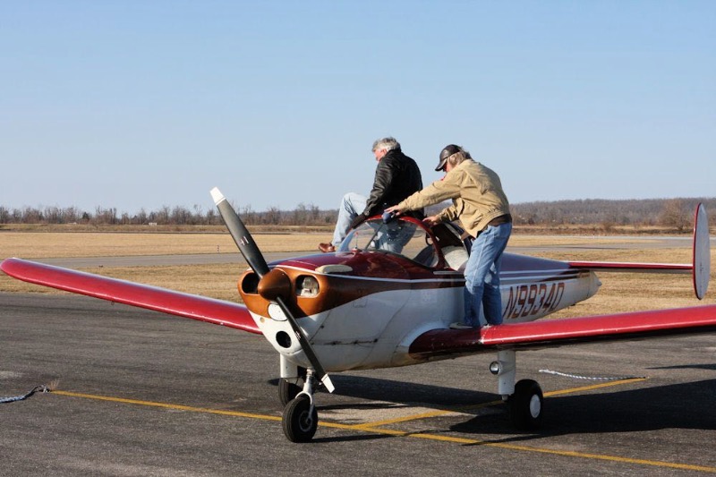

Replied by Lynn Kramer on topic Oil Temp in winter?
I can see how you did that very well in that picture. Thanks. I take it that blocking the airflow entirely is the way to go? The example I say had three holes to allow a percentage of the airflow to continue, but also was told that as the weather got colder those holes could be taped over as needed. So this really helped. Thanks again.

Replied by Larry Snyder on topic Oil Temp in winter?
Terrible picture but you can see the plate covering the opening below the prop. There’s a bar that goes inside the opening and the plate is held on by a single screw. The plate looks white in the photo but it’s actually black, it’s the light.
