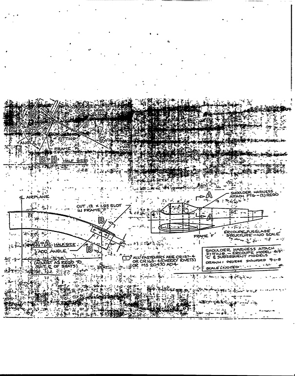

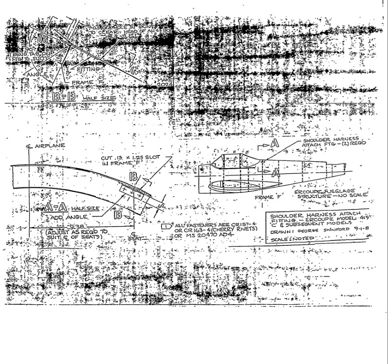

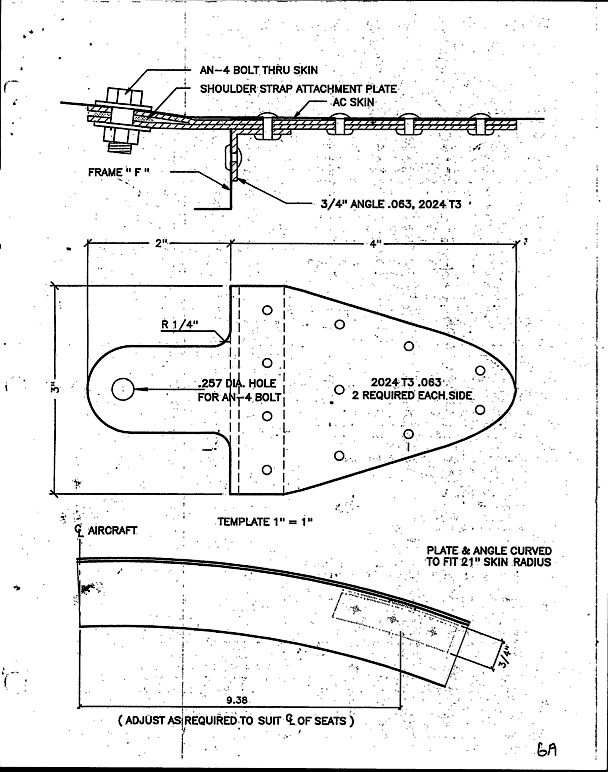

The FAA has acknowledged the value of shoulder harnesses by allowing their installation as a "minor change" per AC 23-17C. No STC or field approval req'd.
As a safety improvement, any shoulder harness should be acceptable. The harness could be attached to a right angled bar the length of Frame F. The front of the bar becomes a doubler for Frame F, a minor alteration as long as holes are drilled only into the doubler and not into the Frame. How the doubler
is attached to Frame F is between you and your mechanic.
