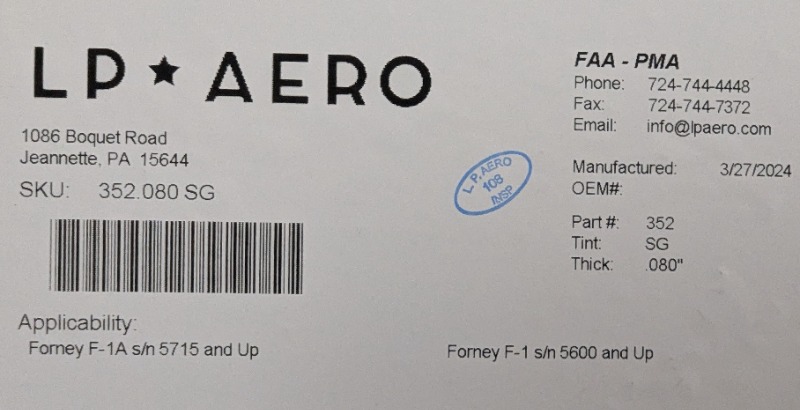

Here's the tag with the LP Aero part number. The "SG" stands for Slate Gray; I'm not sure what the suffixes are for clear and green tint.
I do recommend ordering these from Vernon but this is what you'll get. If he has them in stock you'll get them faster then you would if ordering direct and you can't ask for better than that!

The LP Aero product is "High Quality Optical Acrylic." It's easy to scratch but extremely flexible.
