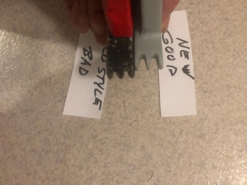

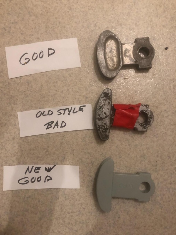

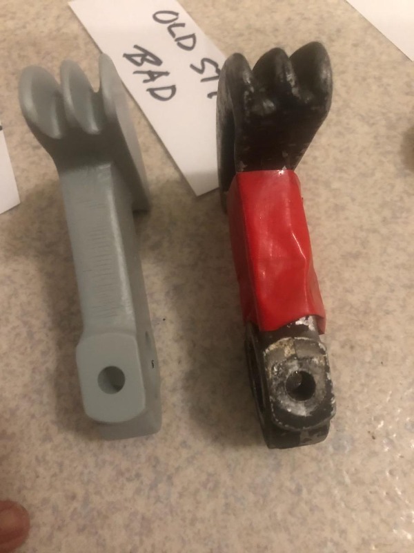

Yes, this is the part that the steering cables attach to, and the original ("bad" in Vernon's photos) caused a sharp bend in the cables which eventually causes fraying.
Replacing with the "good" part makes a more gentle bend in the cables that won't cause premature fraying.
Here's a listing for the new "good" part that mentions that it satisfies the AD
You can remove this part without removing the control column.. after pulling out the bolt that holds the control cables, you tap upwards on this part (the steering quadrant) working gradually around the perimeter where it's attached, and it will come off. A medium small hammer and a brass drift would be the best tools. It's only held there by friction (and age) once the bolt is out. If you want to do the whole set of bearings in the column... The whole thing will have to come out and that's entirely doable but more of an ordeal.

Thank you for the photos!
Are these what the AD is referencing when it mentions those four drawings?
