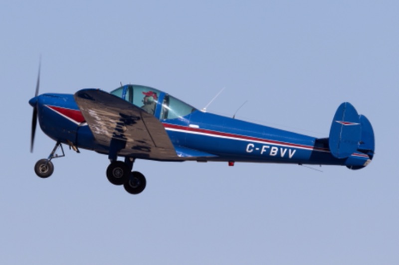

I just bought a 1946 415-C. Is it correct to say that there are no hardpoints on the aircraft to allow you to properly jack it up? Other aircraft I have owned had hardpoints under the wings for this purpose.
Tim

Replied by Matt Gunsch on topic How Elevate Ercoupe to Change Tires
It is covered in the service manual, for the mains you can put a steel rod thru the main gear pivot and lift with a jack. For the nose you can place bags of sand on the horizontal and weigh the tail down.
