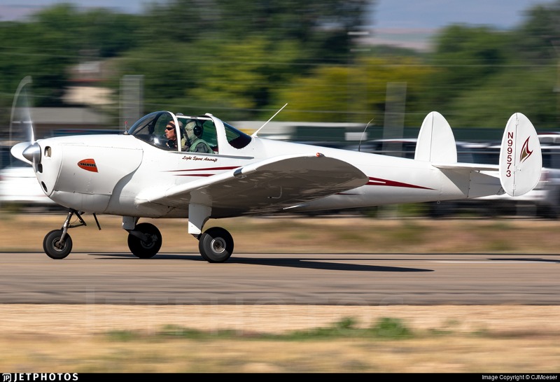

My Ercoupe is very easy for me to fly, I love it. I have semi-handicapped lower legs and they may get worse over time.
My question is: Would it be possible to rig other aircraft such as a Vans to be controlled in the same manner as an Ercoupe? So that the rudder and the ailerons are controlled without pedals? There may come a time that my Ercoupe would not be able to be maintained and I might need to move to another type.
I have read that Jessica Cox was working with Vans to build such a craft, but have not heard anything lately about that project.
