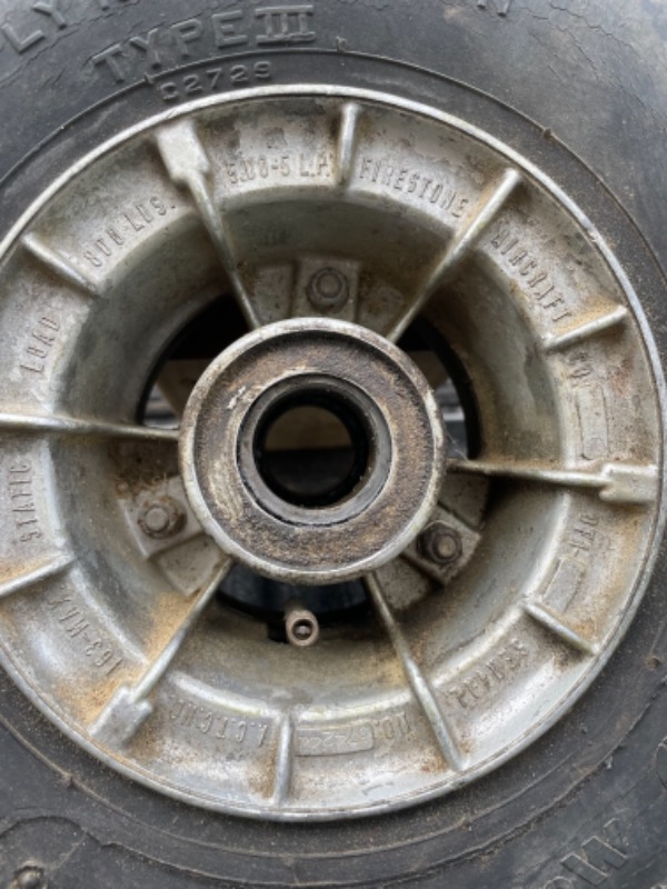

Jerry, remarkable timing - that is indeed the same one I've got! Curious, what do you have under that outer washer? I'd love it if you could document the order of objects up from the bearing to see if we've got the same parts.
I'll tell you that I've searched a great length for a diagram of this wheel assembly, thus far without success.
- Jerry Nograsek
22 Apr 2023 12:01 #14
by Jerry Nograsek
Replied by Jerry Nograsek on topic Nose wheel assembly
I just took this one off the nose of my 415-C yesterday. It seems to be the same type we are discussing. I was surprised to see no snap ring on it.
