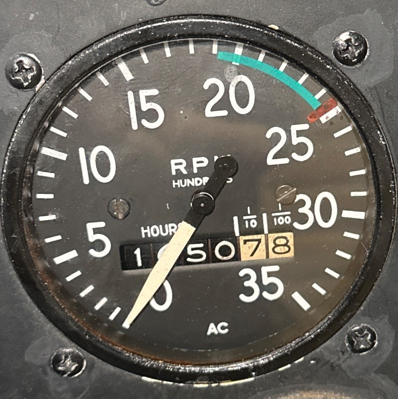

Sorry I should have been more specific about my engine. I have a 65 Aircoupe with the C-90-16F engine.
I reread both TCDS‘s for the correct data before attaching the photo. Neither TCDS had that info.

I thought the C75 had a redline of 2275 and the C85 had a redline of 2575. This tach has the redline at 2475. Which engine is that for?

My tac only indicates the maximum RPM, not a minimum. Where is the bottom of the green arc?

I have never flown a general aviation aircraft without carb heat. As a matter of ‘how do I do that’. I pull carb heat whenever I reduce power below the green arc, and put i arb heat in when applying power above the bottom of the green arc on the tachometer.
