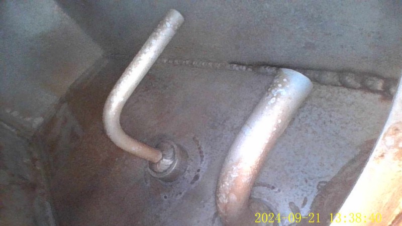

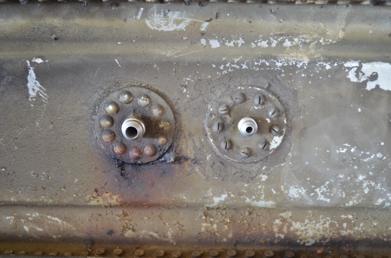

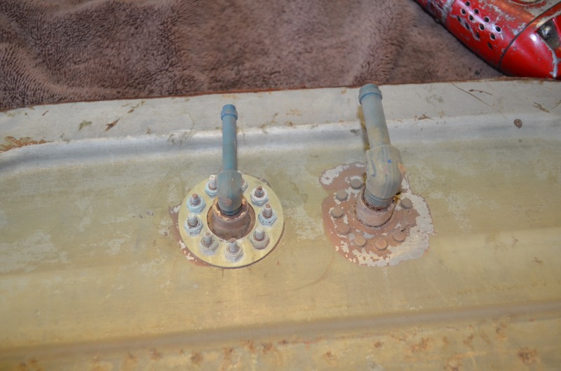

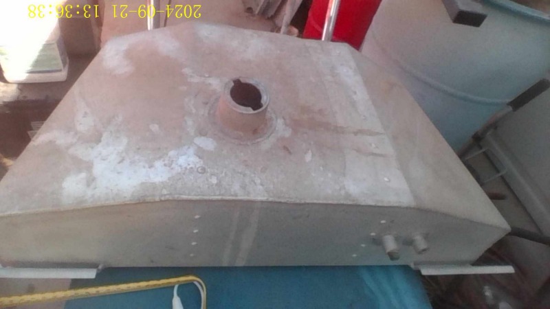

I have a bunch of pictures, not sure this will let me up load them all in one go, 415C Riveted Header Tank
Alon A2 Welded Tank
On My 415G, the return is a aluminum tube that has a joggle in it so it is higher than the inlet, and it's opening is closer to the filler neck.
Alon A2 Welded Tank
