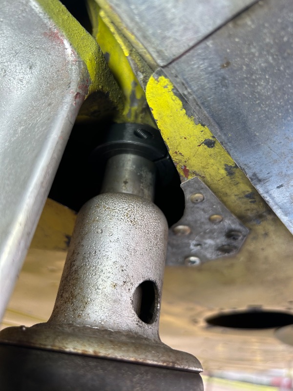

by Jerry Nograsek
Replied by Jerry Nograsek on topic MLG oil
Honing it has nothing to do with the STC. You should hone the inside of the cylinder when replacing the “O” ring. This does not involve the STC
- Scott Thiel
- Posts: 7
11 Apr 2025 22:05 #2
by Scott Thiel
Replied by Scott Thiel on topic MLG oil
I guess that’s my next step. I’ll get the STC rebuild from alpha aviation.
- Kenneth Crofut
- Posts: 24
11 Apr 2025 19:13 #3
by Kenneth Crofut
Replied by Kenneth Crofut on topic MLG oil
Have you honed the MLG cylinder and changed the cup (Dot 5 fluid) or o-ring (5606 fluid) whichever seal you have.
- Scott Thiel
- Posts: 7
11 Apr 2025 19:03 #4
by Scott Thiel
I did that this morning. I had that oleo moving smoothly and freely, but after a flight, it was stuck high again.
- Kenneth Crofut
- Posts: 24
11 Apr 2025 18:03 - 11 Apr 2025 18:27 #5
by Kenneth Crofut
Google ercoupe.info it has detailed instructions on how to service landing gear.
Last edit: 11 Apr 2025 18:27 by Kenneth Crofut.
- Scott Thiel
- Posts: 7
10 Apr 2025 19:04 #6
by Scott Thiel
MLG oil was created by Scott Thiel
