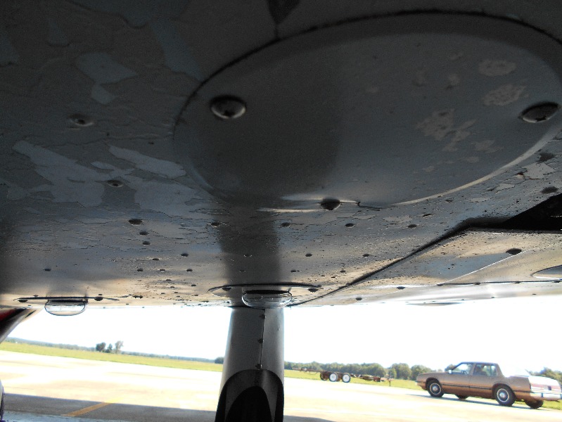

07 Jul 2018 11:41 - 07 Jul 2018 12:08 #2
by Henry Pasquet
Replied by Henry Pasquet on topic Ventilation
I just added a picture of the vents on the right side.
Last edit: 07 Jul 2018 12:08 by Henry Pasquet.
- Henry Pasquet
19 Jun 2018 10:39 - 07 Jul 2018 11:39 #3
by Henry Pasquet
Ventilation was created by Henry Pasquet
On my just completed annual, I had my mechanic install four Snapvents below the fuselage on four inspection panels aimed rearward to suck air out of the cockpit . I got a strong blast of air from the fresh air vent. It is now cooler with the canopy closed, and should be warmer in the winter. They could be replaced with the old ones in minutes any time it may be desirable. Packing air into the cockpit without letting it flow through does little good. Don't ask for pictures. I am old. I have an Alon, but this should help all models.
