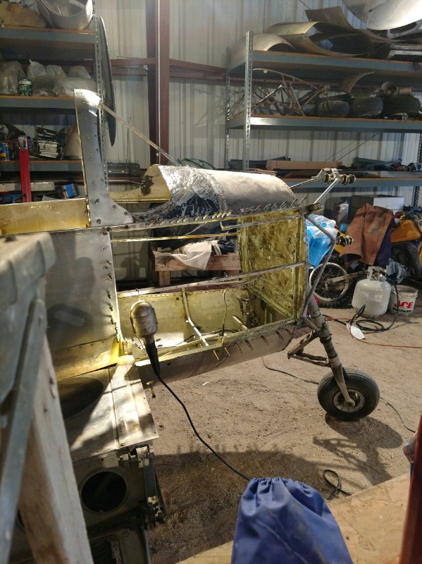

by Ronald Paxton
Replied by Ronald Paxton on topic nose panel replace

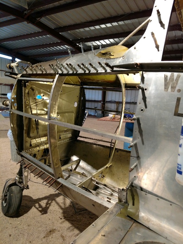

the new frame b is clecoed in place.

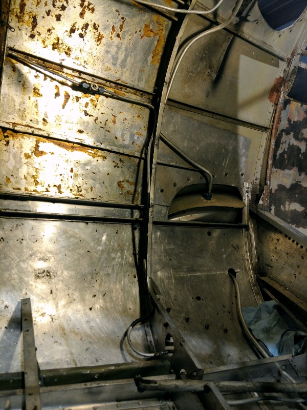

13 Dec 2018 15:14 #8
by Ronald Paxton
thank you. i ordered some more clecos.

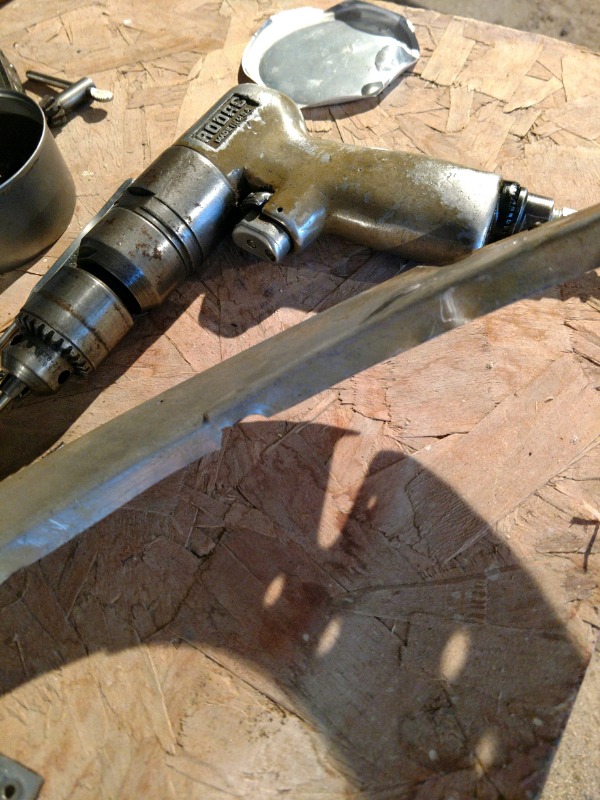

i got the frame b out and it was cracked at the top corner where it was hard to see.

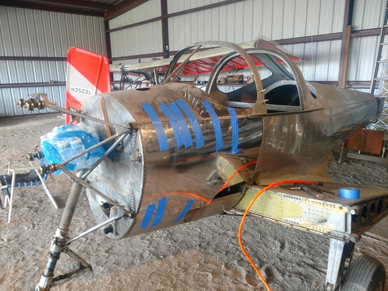

Best thing is Clecoes, lots and lots of Clecoes. Make sure your panel is down tight before you start riveting it in place. Have someone who knows how to rivet on the bucking bar, I have seen too many panels messed up because they "thought" they were on the rivet.

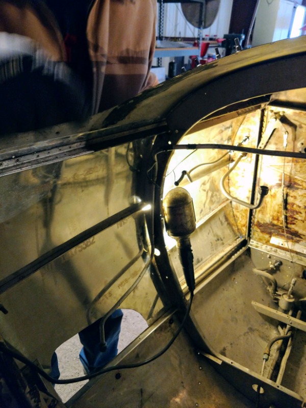

i've made some more progress in fitting the panel but found a slight distortion in frame "b". i carefully inspected the right side of "b" and found it even more distorted. it looks like someone kicked these panels in anger.
i hope i'm not the first person to ever attempt this work.

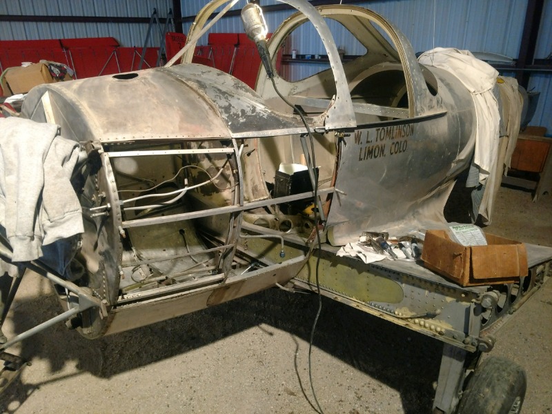

I'm replacing the panels on the side of the nose section. If anyone else has done this before I would appreciate any advice.
