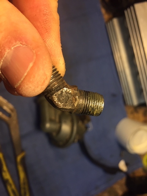

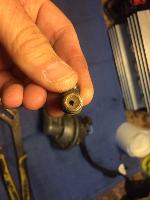

The plumbing is correct in mine. I wonder if the header slowly bleeds back into the wings retrograde through the pump if it has worn out reed valves that leak. Again, that would make sense if it's as old as it seems since it is undocumented in the logs, has no part # stamped on it, and as noted below, kind of questionably maintained.
So, when I disassembled the old pump and took the fittings off it, this is what I found (see pics). The output NPT fitting's throat was blocked with some kind of presumably fuel proof filler that was hard as a rock and had a hole drilled through it, presumably for "compliance" with the AD. Pretty risky if not outright stupid I'd have to say. What if it broke loose and went down further in a crooked fashion so as to block the fitting altogether? Oh well. This is part and parcel with the way the previous owners treated this poor plane and she is certainly full of surprises. I hope I'm getting near the end of the list though.
