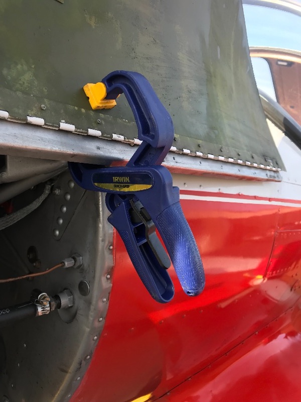

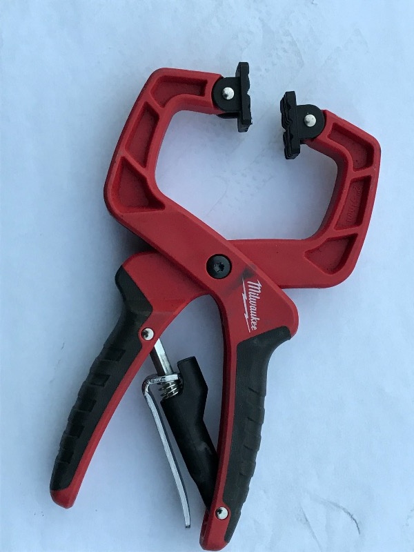

I use a large plastic clamp with a vise grip squeeze lock mechanism across the cowl hinge when the side cowl is fully opened back across the top cowl. Squeeze the clamp lightly only enough to lock the clamp jaws against the inside surfaces of the cowl. I usually place the clamp about 4-6 inches forward of the firewall so the area near the dipstick and gascollator is unobstructed. These clamps are available from Home Depot, Lowe’s and Harbor Freight for $2-3 each. I will try to get pix of these tomorrow to post on the EOA Facebook site. The previous owner, Tom Murrell, provided mine.
