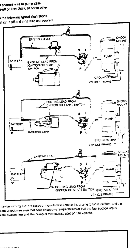

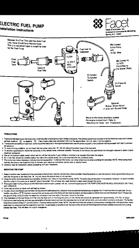

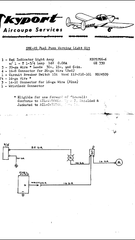

30 Jan 2020 21:39 #5
Replied by Lawson Laslo on topic Replacement fuel pressure switch for M4007-4, o-200 crankshaft electric pump
this is all I can find in my book
Photos are below
Hope this helps
Let me know if you need anything else
Photos are below
Hope this helps

Is there any chance you would have a schematic or sketch for the fuel pump installation. Just purchased ERCOUPE and now sorting out 74 years of “improvements”. It would be greatly appreciated.
