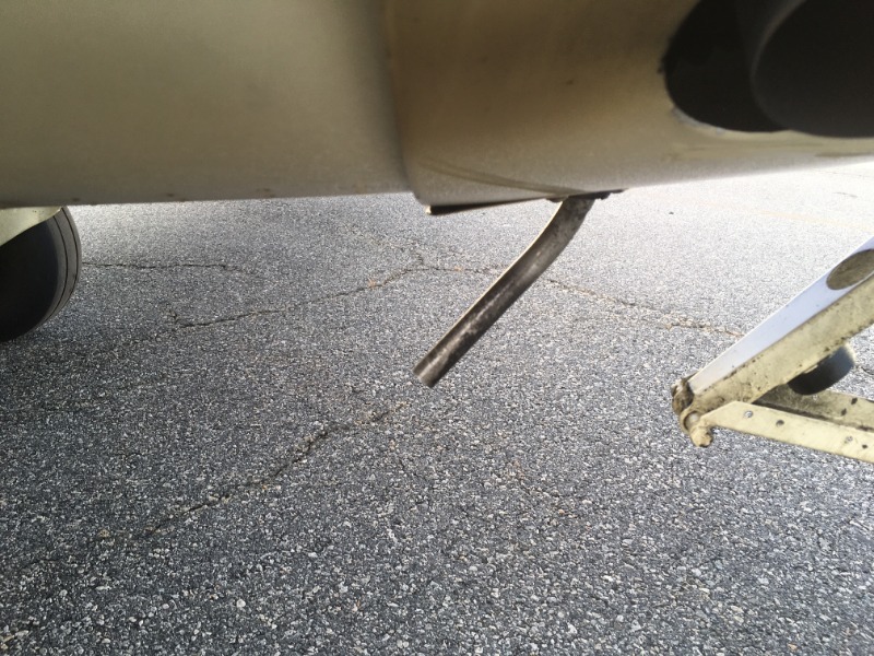

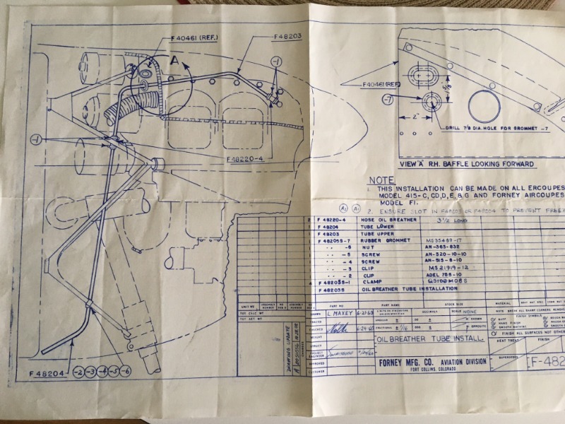

21 Oct 2020 14:36 - 21 Oct 2020 18:30 #2 by Dennis Tar
Replied by Dennis Tar on topic Crankcase Breather Tube?
Attached is a picture of my extension below the cowl based on the attached schematic for the proper routing of the tube assembly to the crankcase of a C85.
Hope this answers your question.
Dennis Tar

Hello,
How far out should the crankcase breather tube extend out from the bottom cowling?
