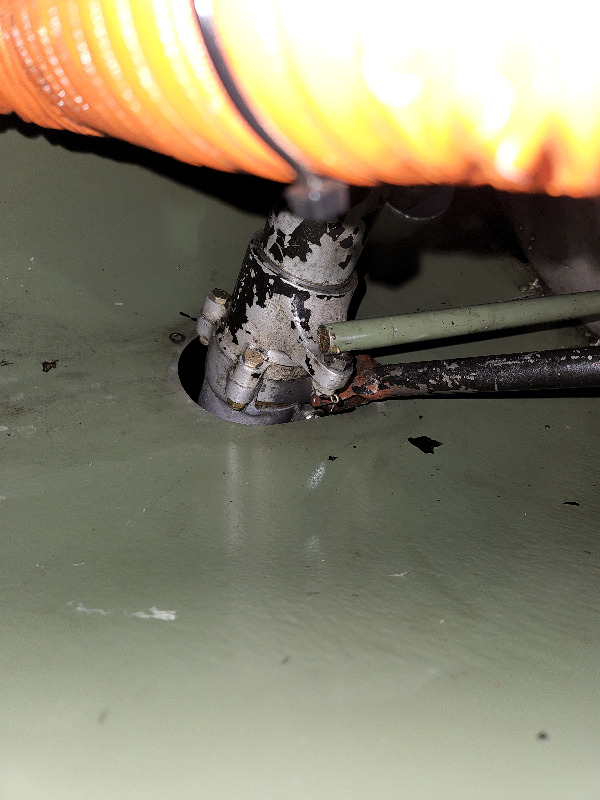

I am of the opinion that if you are using the steering linkage and nutcracker to dampen shimmy, you will be constantly wearing out the nutcracker bolts and steering link bearing. See if you can find the cause of the shimmy: tire out of round, tire out of balance, loose bearings, others can probably offer other reasons.

Hey everyone,
I am fighting a nose wheel shimmy right now. A few years ago I replaced the nutcracker bolts and all has been good until recently. I maintain 17psi but, recently the shimmy has been fairly violent. I went through the steering components and I have two spots with play in them. A little bit in the yoke but, it seems very minimal. The second area is where the two steering collars meet. My assumption is there should be no play at those two collars but, I wanted to confirm that before tightening. Anyone know? Next step was to take the tire off and send it in for dynamic balancing.
