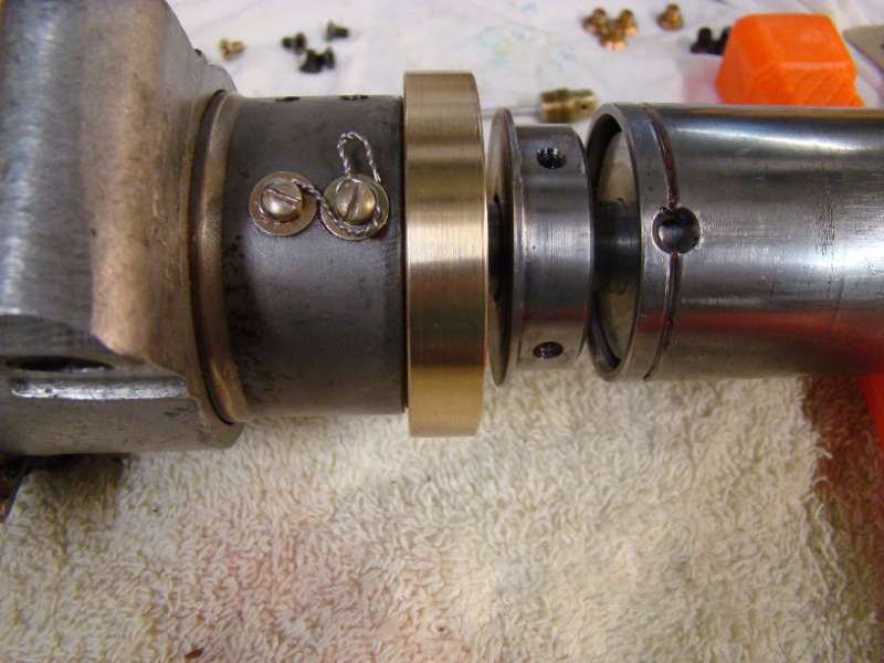

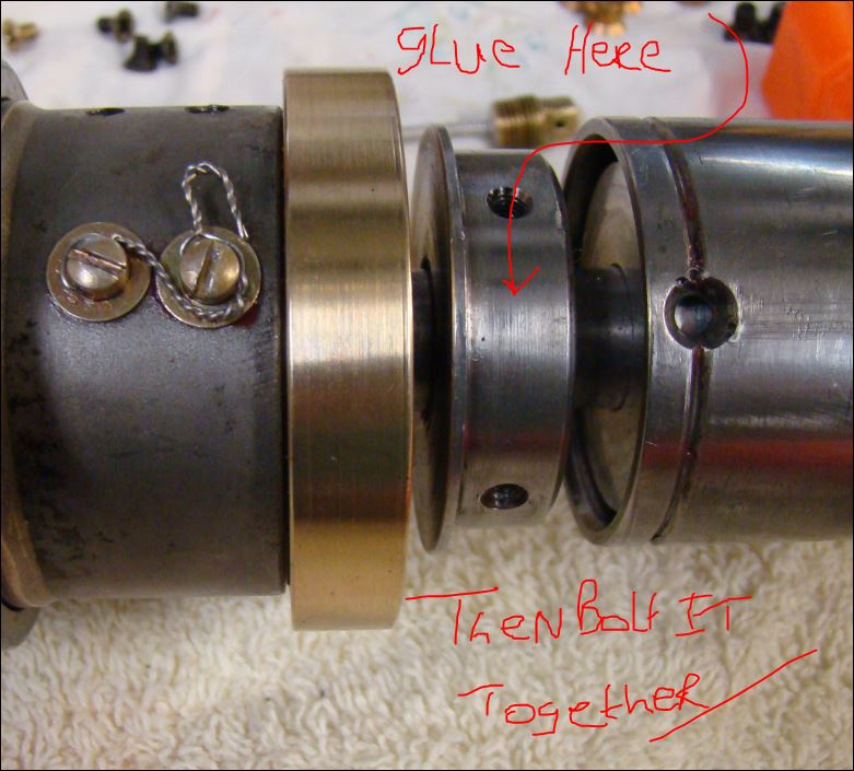

Does anyone out there in Ercoupe Land know where I can obtain some 3M type type EC 570 glue? It is part of the reassembly for the nose gear oil seal... I got a rebuild kit from Vernon but this item slipped by me and I am sure there must be another glue/cement/Permatex, etc to use in place of a 50 year old glue... Thanks in advance for your help...
