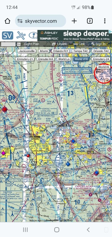

I don’t know what the consensus is, but unless you are absolutely sure you will never enter class C or a mode C ring it’s worth having. I live in a state with few controlled airports but I like to fly to a little airport close to downtown Memphis for lunch sometimes. Seems like fairly often I am in Kansas City, St. Louis, Memphis Oklahoma City or some other airspace.
Not to mention that flight following works better with ADS-B.
Even though 75% of my flying doesn’t require ADS-B
Out, I’d sure miss that other 25%!

I've been trying to decide if I actually need a transponder/encoder/ADSB out. My airplane is hangared outside the Twin Cities Mode C veil. I can circle around it to visit friends and family. The only time I might need ADSB is if I fly to Fort Myers, Florida to visit in-laws. Looks to be a narrow gap between Orlando's Mode C and Tampa's Mode C, above the 1,600 ceiling of Bartow Executive's Class D airspace, where a guy could fly the Coupe without any electronics or permissions at all. Am I reading that right? If so, maybe I'll put a few thousand into gas instead of avionics. What's the consensus?
