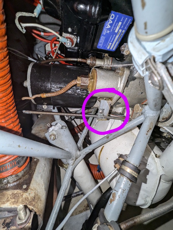

My throttle cable has one support in front of the firewall, which leads it down between the bottom of the engine and the top of the oil tank. Shown in purple.

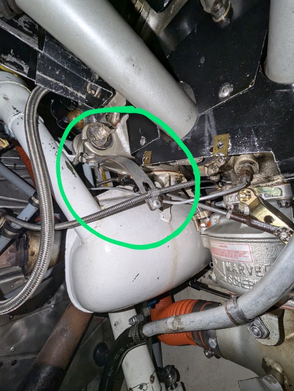

My mixture cable has two supports. One is shown in the extreme left of the photo and is a simple adel clamp to hold it free of rubbing anything. The interesting one was made from a bent steel strap that's secured to the engine mount. The mixture cable curves around to come in 90 degrees to, and just above the throttle cable. Shown in green.
