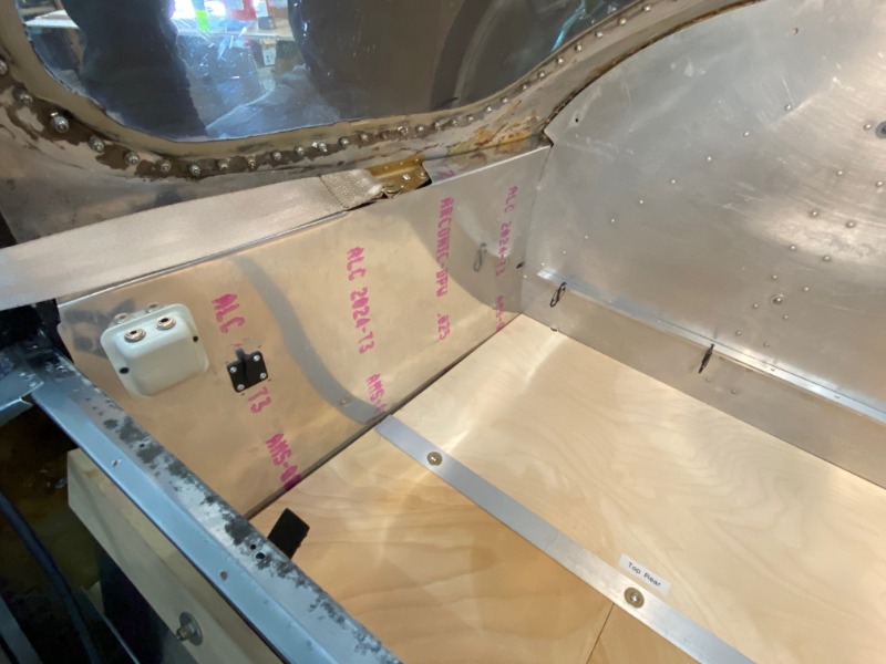

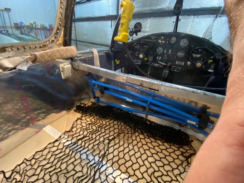

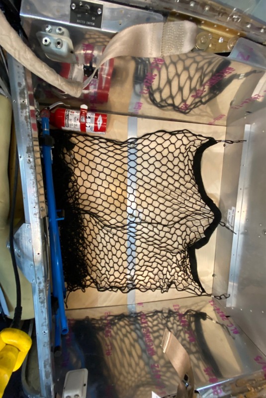

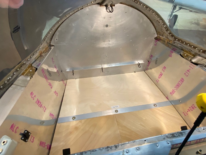

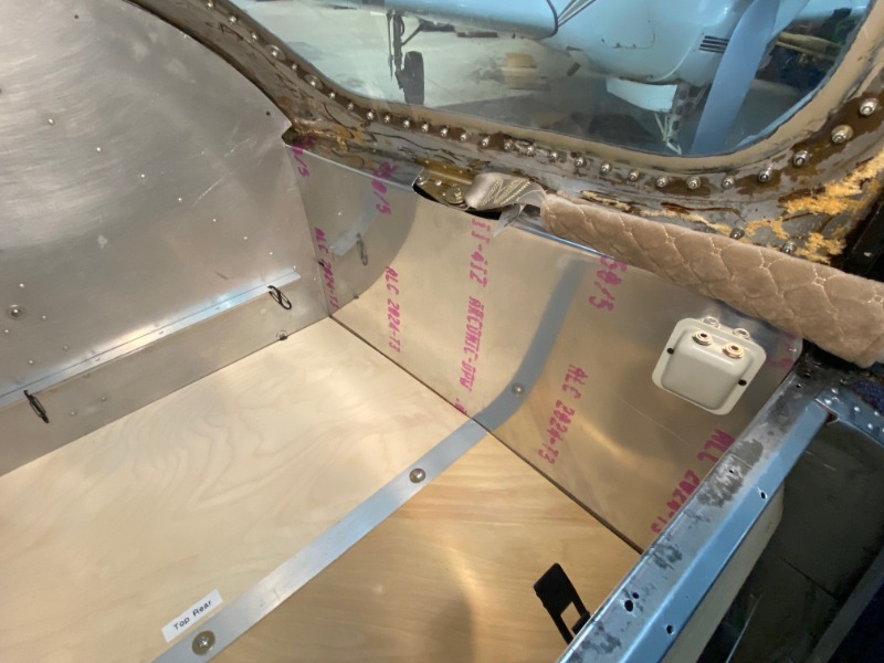

Here are a couple pics of the final install. I've added a few non-std items;
1) the rear bulkhead is 1-piece 2) sheet metal doublers added for master switch and battery charging port (both on Right side panel) 3) headset jacks 4) towbar clamps behind seat 6) fire extinguisher mount on floor 7) strips on aft bulkhead and fwd wall with holes to clip in the cargo net.
Overall very pleased with the installation, the side panels are a challenge to form and fit, but everything else was pretty easy. For the Alpha STC be aware that you only need a little 1/2" marine ply (to fill the channels in the formers), and not a full sheet. The Alpha hardware kit ($50 for all nuts / rivets, etc) was a nice touch... ensured we had all the right bits for the install.
When I have time I will put this all together in a reference file for anyone installing the STC. Finally I would add that I believe in paying AlphaAviation the $299 for the STC and plans ... it is the 'right' thing to do in my opinion. They have invested in purchasing the STC and supporting the Ercoupe community (in addition to being a small town family run company) -just my two cents.
if anyone has questions let me know
