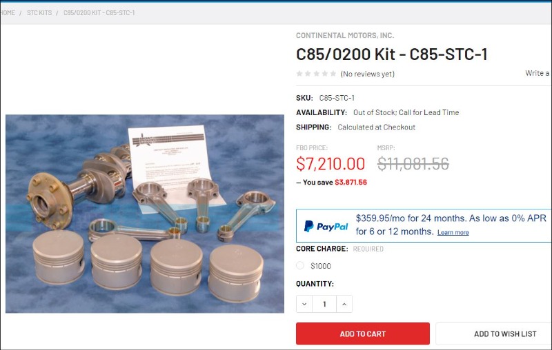

Replied by Ron Holmes on topic 4 cylinders for C-85 stroker
17 Mar 2026 15:28 #2
Replied by Warren Hampton on topic 4 cylinders for C-85 stroker
Your are right. The 1/4 ' is in the Stroke not the piston Dia. At 81 I do sometime get confused.
