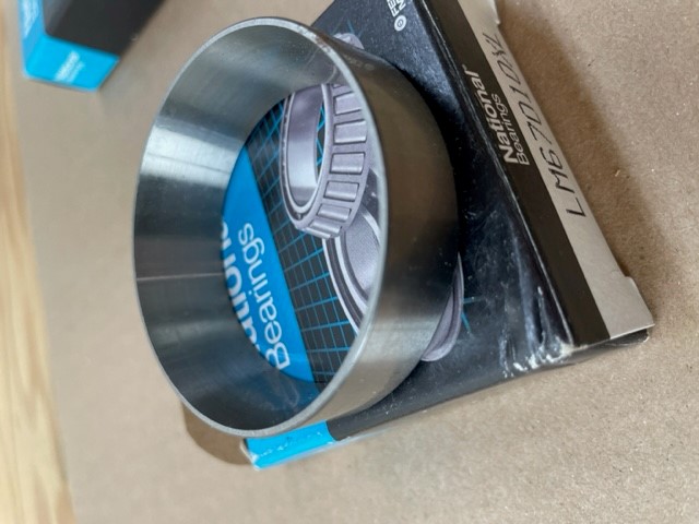

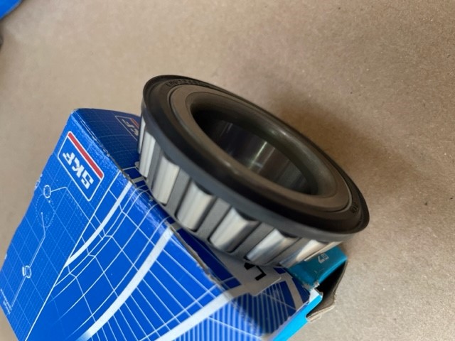

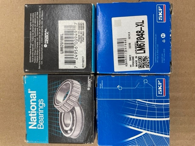

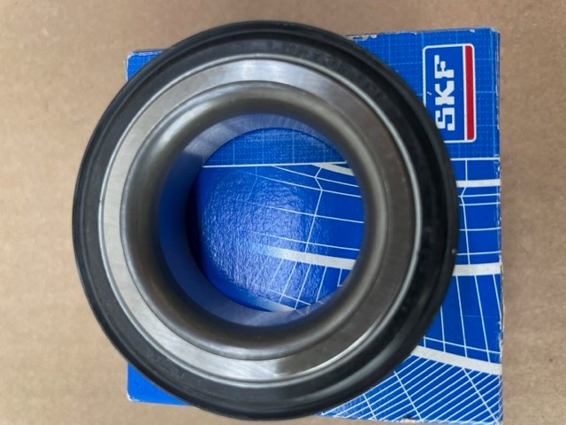

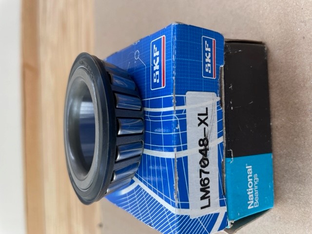

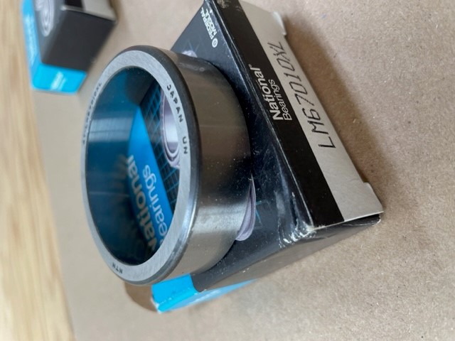

Hi All;
A big thank you to Vern Gregory for finally solving the nose wheel bearing issue on my Alon.
I should have called him first as we all know.
It turns out that I had all the correct parts for my nose wheel after all. Vern told me that the Alon has a different set up. No recess/groove for a snap ring to fit in to to hold the bearing and cup into place. These are the only two parts needed for my particular Goodyear nose wheel assembly. The bearing has an integral rubber flange that seals the unit when placed inside the cup. And that's it. "Good to go" as Vern said. The rubber flange had separated from one of my original bearings which lead me on this little journey. A quick call to Vern and he sent me the proper replacement parts.
I included the pictures for any of you that might have the same issue.
Cheers
