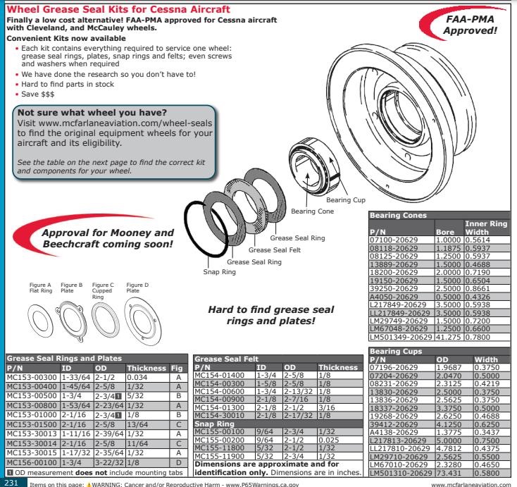

14 Dec 2022 13:31 - 14 Dec 2022 13:35 #11
Replied by Warren Hampton on topic Goodyear Nose wheel assembly 9532962 parts
Martin, I looked up the felt I got from Aircraft Spruce #06-02872 It is hard to find the flat retainers the snap ring not so hard. The. Parker / Cleveland parts are priced way high for little parts. You mit call Vern to see what he has. I know he has a few Alons and an M10 down there at his salvage yard 803-360-2061 Good luck!
Last edit: 14 Dec 2022 13:35 by Warren Hampton. Reason: deleted parts
14 Dec 2022 10:53 #12
Replied by John Jones on topic Goodyear Nose wheel assembly 9532962 parts
I have been searching for the same for the Cleveland wheel with no definitive results. I contacted Parker (manufacturer) if there was a substitute for the 40-17 and received this reply: "We spoke yesterday but I wanted to close the loop by saying the 40-77 is a 5.00-5 wheel and is close to the 40-17 wheel you asked about." I also check with Macfarlane about parts and they provided this chart. I also looked on ebay for both the Goodyear and Cleveland wheels and the only ones were what I would consider "ratty" at best. John
