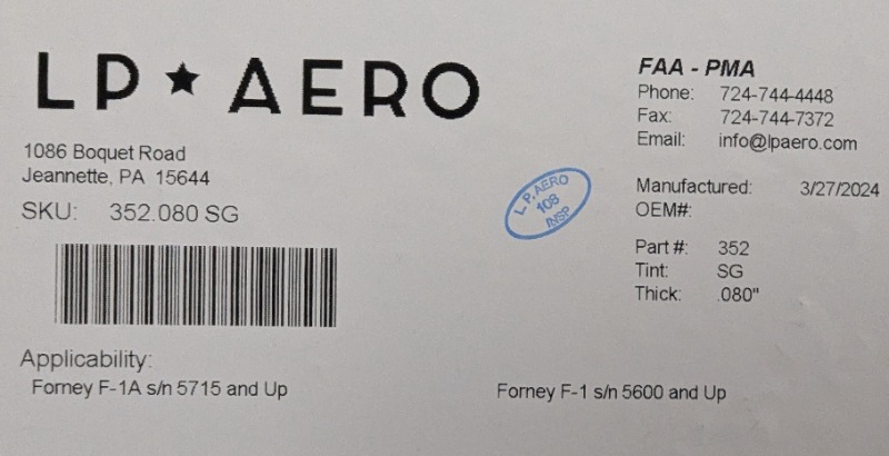

Replied by James Davis on topic 415-C Side windows info
Here's the tag with the LP Aero part number. The "SG" stands for Slate Gray; I'm not sure what the suffixes are for clear and green tint.
I do recommend ordering these from Vernon but this is what you'll get. If he has them in stock you'll get them faster then you would if ordering direct and you can't ask for better than that!

Replied by Brooks McNew on topic 415-C Side windows info
The LP Aero product is "High Quality Optical Acrylic." It's easy to scratch but extremely flexible.
