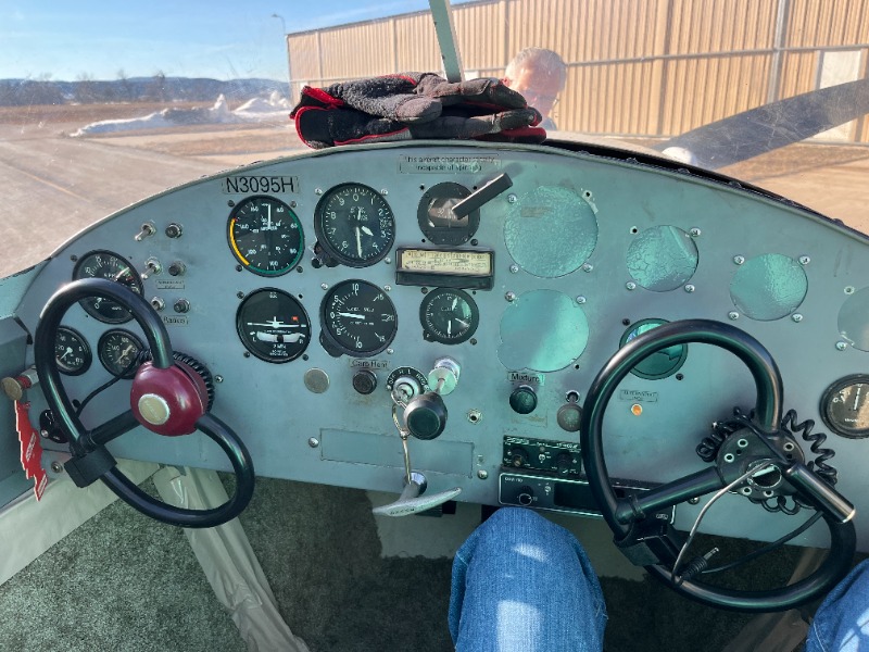

The Ercoupe panel isn’t hard. 3 Garmin GI 275s will replace almost everything. You could dismantle the old one and just copy it.
I just purchased old stock pieces for my Alon to duplicate from Vernon Gregory to keep my aircraft in service while I fabricated their replacements.
The 3 piece Alon center panel is more difficult. The center panel requires bending and TIG welding to fabricate the replacement The outer panels are simple

I have been thinking about cleaning up the panel in my Ercoupe. It's not only ugly, which I could live with since ugly is cheap, it's also hard to see the instruments way off to the side.
Instead of purchasing the blank panel from Univair for $450, I'm thinking of laying a piece of blank aluminum over the entire panel, and cutting new holes where I want them.
Is that what you meant when you said "reface" the panel? How hard is it?

Mac, If you want to reface your panel, I have a Pattern for the curvature at the. top.

Book came in today Warren thank you! Brings back memories, my dad had similar books from when he was a kid in the 1940's. The photo of the panel is absolutely perfect is that from your 'coupe?, It's a good reference to restore Tweety's, very much appreciate these sir!
