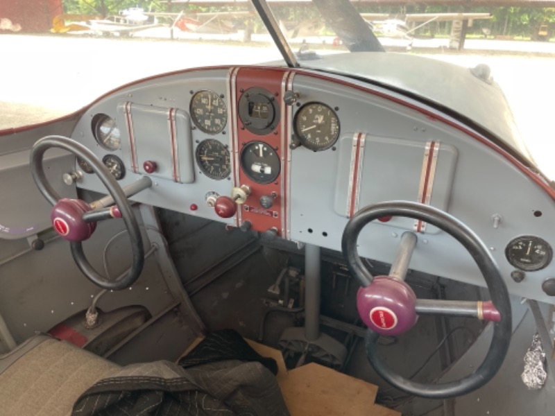

Where will it be installed?
- Jerry Nograsek
03 Jul 2023 16:34 #14
by Jerry Nograsek
Replied by Jerry Nograsek on topic Weight & Balance and Fuel Capacity?
Took my panel back to as close to original as possible. Will have to add some item under the panel
