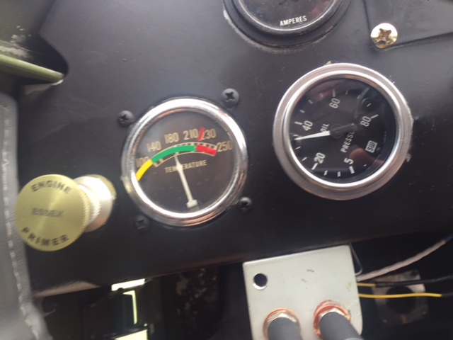

After a lot of experimentation I decided to try the oil specified in the C85 maintenance manual. As it turns out, it says that W60 oil should be used with ambient temps greater than 78 deg. So I switched out the oil (again) with Aeroshell W120. Here's the result:
The gauge is new by the way and I haven't gotten the color coded arcs on it yet. I replaced it to make sure the problem wasn't gauge accuracy. In any case, the pressure at cruise rpm, 180 deg oil temp, is now well within the 30-35 psi green range as specified by the maintenance manual. Straight W50 ran about 28 psi at 180 deg. Also, oil analysis, done on oil that was 25 hours old before it got hot here in SD and oil pressure became an issue, was stable and ok with just a tad too much copper.
I'm gonna say this is safe for summer flying now with close monitoring. When Fall comes, I'll probably be able to switch back to 20W50 weight oil. We'll see.

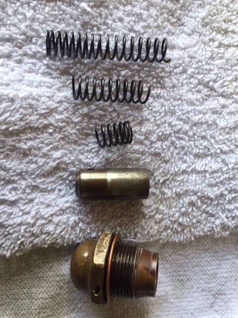

Thanks Pat. I might just give you a call. But first I'm gonna try following up on what I found today.
After pulling the pressure relief spring I found things as shown in the pic and whereas the spring being broken into 3 pieces couldn't have helped, there was still some compressed tension in it. My theory is that it had to be shortened a little as a result though and this would have been made worse as the wire heated up causing it to lose even more tension and allowing the piston to fall away from the bypass channel prematurely. I ordered a new one from Aircraft Specialties today along with the copper washer for the dome nut that closes off the entire affair and will report back once it's installed.
Chris
