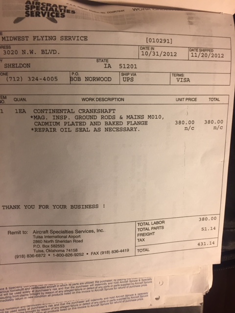

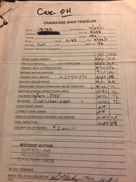

That is good news. What about the camshaft bearings? Have you tried another direct reading gauge? It could still be the pump/ relief valve.

Even 50 weight oil gives low oil pressure when hot with worn bearings or pump. Did they turn the crank on the last overhaul or just put in new bearings on a worn crank to save money? Oil pressure on older cars drops as the oil heats up, even with 20X50. Worn bearings.

What's strange is that it's so temperature dependent. Multi-grade oil is supposed to retain its viscosity throughout the operating temperature range. Why then would the low oil pressure seem to be so temperature dependent?
